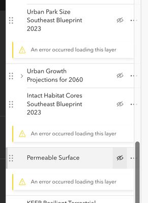

Hi@PatrL - In my message above from Oct 2024 I shared the information about best practices for the recommended number of layers in a map that's used in a story.
The map you linked to has more than twice as many layers than are recommended, so that is why it's causing issues on older phones (I was testing on an iPhone 15).
To address the issue there are several things that should be done:
  1. Remove map layers if they are not being used, broken, or not essential to the story
    • Several layers in the map you linked to show errors (see screenshot below)
  2. Combine layers, where possible.
    • I'm not familiar with the data, but for example in this map many/most of the layers in the map contain only a single feature. This is not a best practice for basic map design regardless of whether the map will be used in a story or not. The study area outlines should all be in the same layer, the forest areas should all be in the same layer, etc.
  3. Where layers can't be removed or combined, separate them into multiple web maps to keep the number of layers below the recommended limit for a single map.
