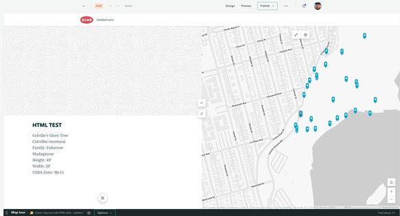

@Smith_Mike - Sorry you are having a bit of trouble getting things to work as expected. I pasted the exact HTML you included above into a feature service and used that to create a map tour and it seemed to look as expected. See screenshot, below.
Can you provide more detail about the exact steps you are creating your tour? Have you checked out Abby's article about using Arcade in map tours?

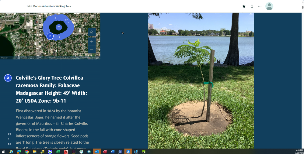

I've been at this a while so I've tried many things. The first thing to try was just use the web map and feature from the Classic Map Tour and I selected the attributes that correspond to the name and description. This worked to put the values in the story map, but the html tags were showing and not acting. I copied the feature to another name and took out the html tags thinking maybe the new story maps would not need them. No stacking. So I made another feature and broke the name feature into several attributes hoping to be able to put in more than one attribute. Nope. Then I thought a concatenation of the attributes might work with a line return as done in Arcade. I went into ArcPro and created a label in Arcade that stacks because of the textformat.newline constant. It worked well in ArcPro, I copied it and tried to paste into a text field of the feature, but the sequence was too long.
So even with the html tags as you used. I see what is below.
As you can see all the data is there, but seems to only use word wrap.
