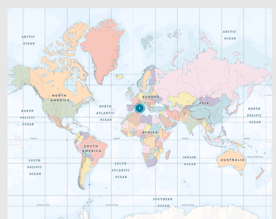

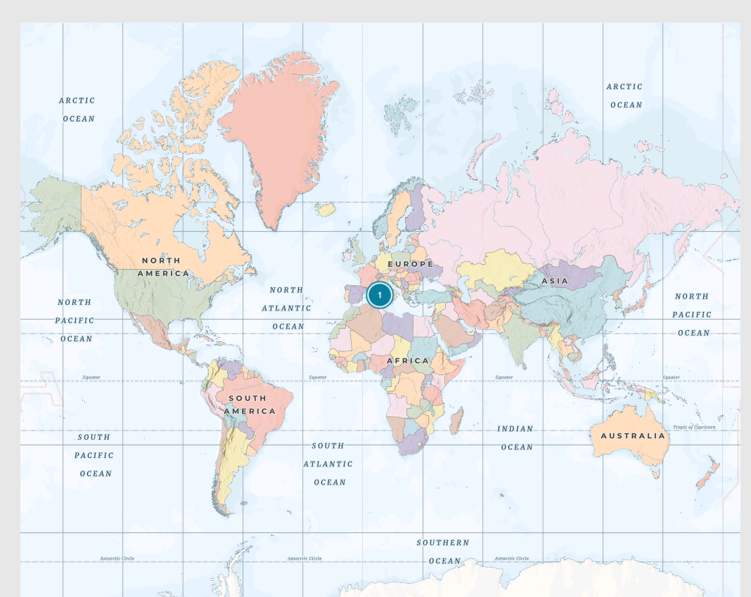

HI,
how do I set the size of the map when I create a Storymap tour using the "start with the feature service"  function? In fact, every time the map is loaded with the maximum extension and not the regional one I need.
On the other hand, setting the extension at the feature layer level does not solve the problem.

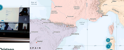

hi Owen,
i have 5 points.  You only see one because they are very close. Here is a more detailed view.

when I use the default "explorer" layout it seems to work fine, but when I use the "guided tour" layout it may not work and the map extension is not correct.
