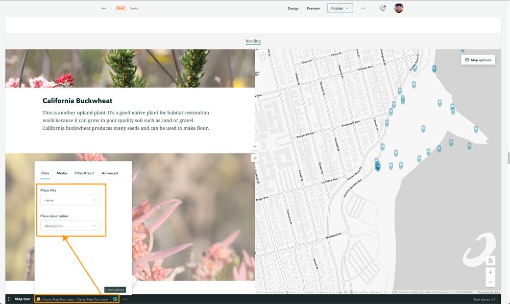

Ah, ok got it. Looks like you have created a map tour using a feature layer. "No information provided" means that you haven't set any fields to be used for the place titles and descriptions.
When you create a tour, the tour builder looks for fields that are good candidates for this (fields with "name" or "title" or "description" in the field name or alias) and picks one, if available. Your dataset must not have any fields with these names, so it didn't know which ones to pick and you'll just have to set them manually.
Click on the gear (or your feature layer name) at the bottom of the tour builder and set the fields on the Data tab, as shown below.
