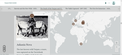

I am currently working on a storymap and attempting to use the map tour function. I am able to create the map with the points I want to showcase with images, and I am able to see the map in the background as I scroll through the guided tour when I am viewing the storymap when I am signed into my account. However, when I try to view the storymap as it is shown to the public, the map does not show up in the map tour. All of the points and the photos are visible, but the map is not visible in the background.

@KatelynnBaerg - I'm sorry you are having an issue with your map tour. Could you share the link and a screenshot so we can take a look at what might be going on? Could you also let me know whether you are using a custom basemap in your map tour or not?

The base map is not a custom map, the first screenshot is what I can see when I am logged in, and the second screenshot is the public view.
