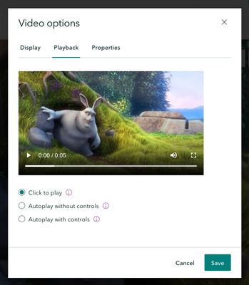

For anyone who may not have seen this, uploaded videos in guided tours, sidecars, and inline in the main part of a story all have playback options so you can customize how the video behaves.
For more info see What’s new in ArcGIS StoryMaps (March 2021) (esri.com)

RodriguezIvonneITD
It seems to me that this has to do with the ESRI/your job company) privileges, I don't see this option (Display - Playback - Properties) in my StoryMaps options...
RodriguezIvonneITD
Sorry, I got it, Not a privilege issue/
You can use this options when you download the video from your computer, but it doesn't give me the option when you use the link to add the video or embed it. That options do not exist when adding as a link .
