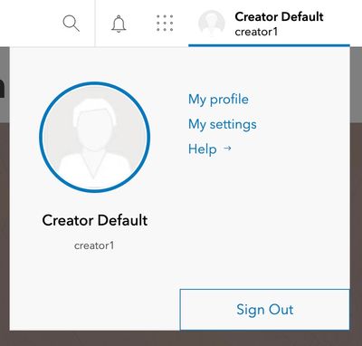

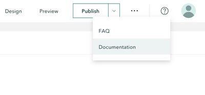

On Enterprise there is an installed/local version of the help for your version on your portal. For example, the FAQ you mentioned from the Online version of the help would be here on your enterprise portal: https://[your-server-name]/[your-portal-name]/portalhelp/en/storymaps/get-started/faq.htm.
You can launch the local version of the documentation/help from the (?) menu in ArcGIS StoryMaps or from your profile menu in ArcGIS.
