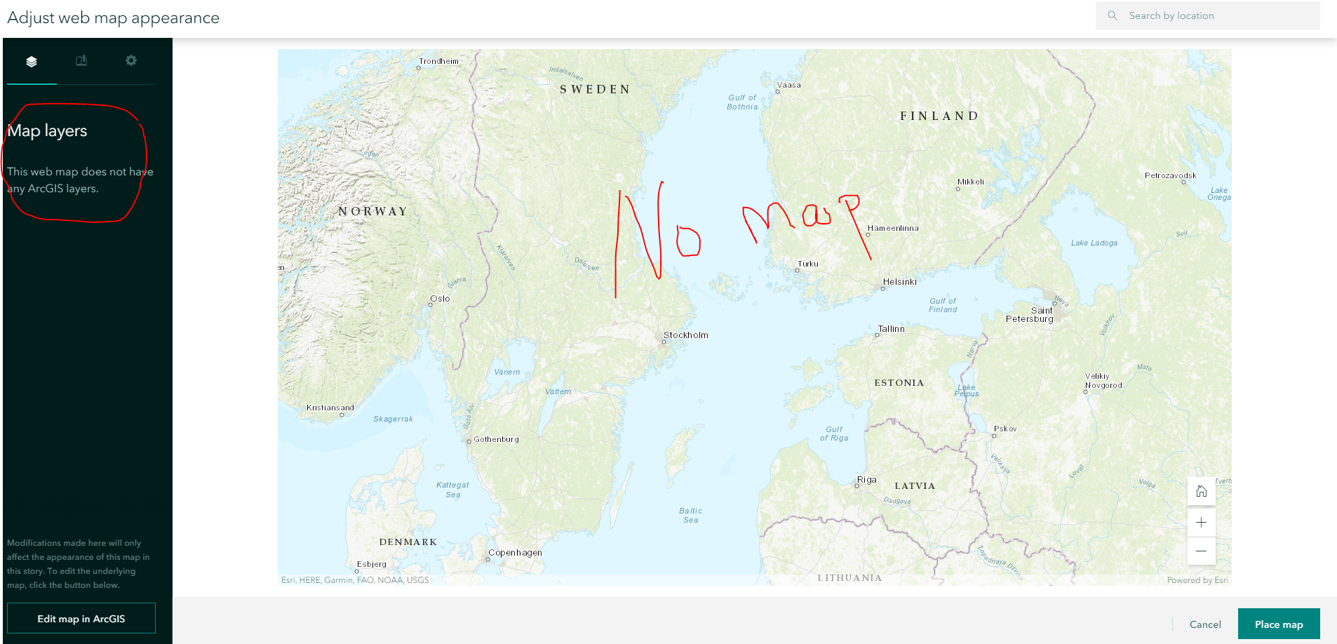

We have a number of external wms layer that we want to add to the new storymap.

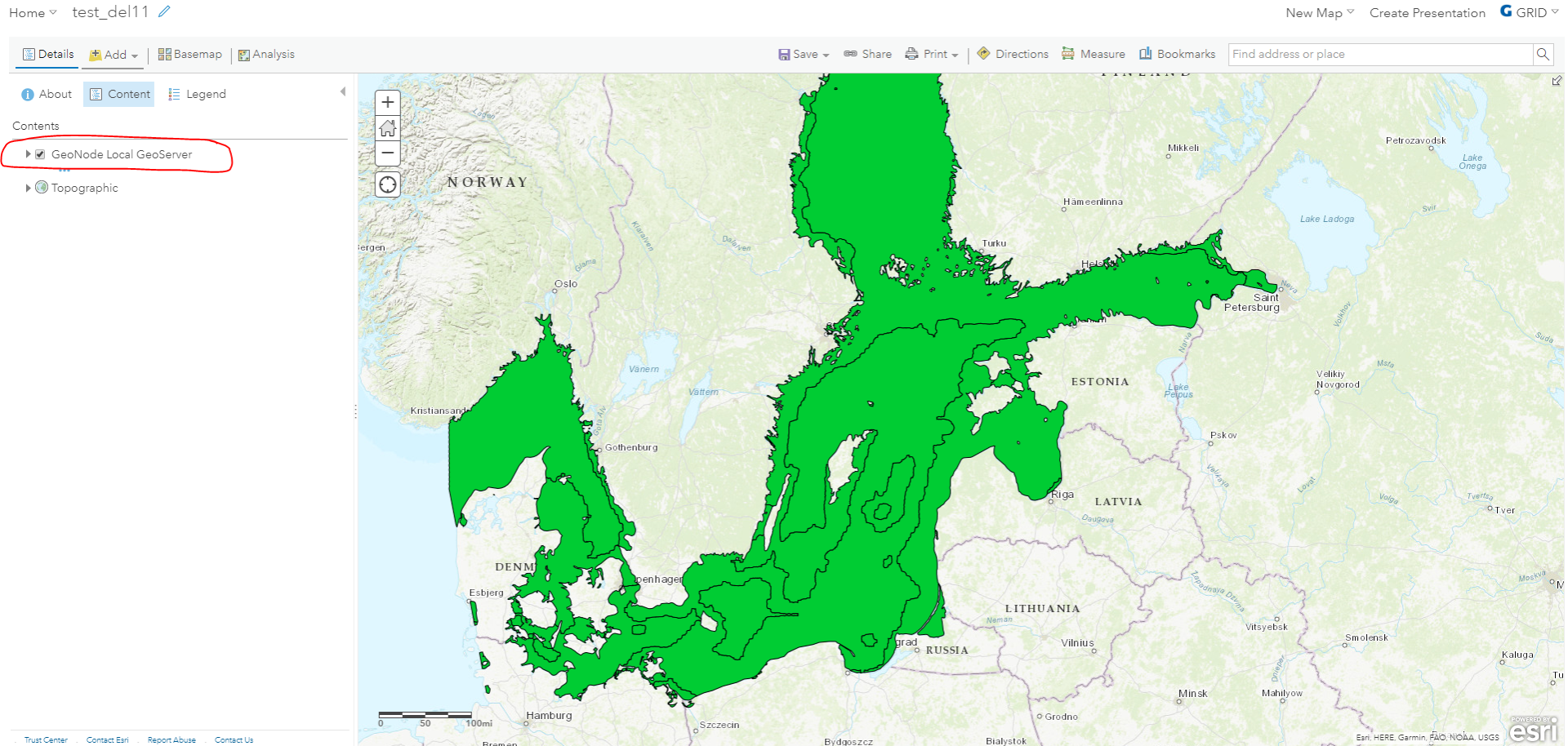

We have created an ArcGIS online map using wms layer.
But when we are trying to add map to the new storymap the map is not visible even it is not listed in the legend.
I can easily add maps to the ArcGIS classic storymap platform but it seems new storymap platform does not accept the WMS layers.

 The layer is visible in beta map and this time I have saved the map with a new name.
Further, I tried to add a new map to the storymap  but again it's not showing anything
I have also tried to add the basic viewer map as embed /iframe but it throws an error
Pleases note that we are using WMS layers from GeoServer.

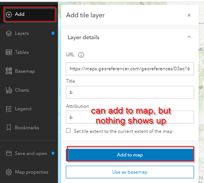

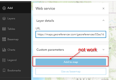

Hi, Owen,
I have similar problem when I tried to add a WMTS service to the new Map Viewer (which worked using Map Viewer Classic). I tried multiple links, but none of them worked. I applied Web service and Tile service in the new Map Viewer. Both of them does not support the WMTS link (Here’s the link for my Georeferencer map:
https://maps.georeferencer.com/georeferences/03ac16a0-acfc-48bc-9675-68f978accc14/2021-03-10T16:58:1...).
Thank you!
