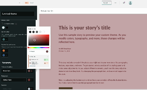

For #1, at the moment, authors are not able to change the secondary background color. However, this is something that we are hoping to allow customization for in the near future. I will keep you updated on this, but for now, making the Text color a bit darker/lighter should allow for a higher contrast between the text and background.
