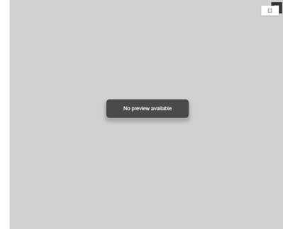

I used to use classic storymaps to embed pdfs into them and they worked fine. I've saved my PDFs on AGOL, I've shared them publicly to get a link. I'm trying to embed them onto the right hand panel but the link seems broken? This is all I see:
When I click into it to make it large the URL is scrambled, referencing google drive in the beginning of the URL even though there is no mention of google drive in the URL I entered? I've tried this several times now and it's not working.
This is the URL I'm trying to work with: https://jacobs.maps.arcgis.com/sharing/rest/content/items/0627d609f98e42e59650ecd7ba062182/data

@FiadhNiDhonnchadha -- Thank you for reporting this issue. I am able to reproduce the behavior you described. We'll look into addressing this in on of our upcoming releases.

@FiadhNiDhonnchadha -- Embedding a PDF item in the narrative panel of a sidecar or inline (in the main part of the story) are still working as expected, so you may be able to use one of these options as a workaround for now.

@FiadhNiDhonnchadha -- This issue required some significant work to address, but our release next week should restore the ability for PDF items from ArcGIS Online to appear in the media panel. Please keep an eye out for a notification inside ArcGIS StoryMaps to know when the update is released.

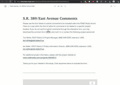

Did the new release change how existing PDF hyperlinks function?  We have been doing a lot of online meetings and have a comment form from one here:
https://storymaps.arcgis.com/collections/c9f72abccffb4745acf5a8570721e34d?item=6
Prior to last week, our links pointed the user to the client's site for PDF downloads.  These links allowed the user to download the PDFs immediately upon hitting the hyperlink.  This week, we lost this function and all of the links are broken on all of the Storymaps we have built over the past year.  On the link above, click "HERE" to see the loss in function.  The URL is correct, you can right click and download or hit refresh and it downloads.  We have tons of these links to the client's site that we will have to update if this isn't resolved.

Hi @AmyWiwi -- There haven't been any changes in hyperlinks that I can think of that would affect this.
I'm not able to reproduce what you've described. When I click "HERE" the PDF downloads and I can open up the file from my computer as expected.
Are you seeing this issue in a certain browser or a certain machine? Is it possible there's a browser extension affecting the download behavior?

It only works in Firefox and Safari, not in Chrome or Edge.  We did pinpoint that the original StoryMap allows the download, but accessing through the Collection does not.

@AmyWiwi -- Looks like the latest update to Chrome/Edge (they use the same browser engine) broke this.
That GIF I shared above where it was working as expected was using Edge 94, but I just updated to the latest (v95) and now I can reproduce the issue you've reported.
We'll take a look and see if it's a bug we can report to the Chromium Browser team or whether it's a something like a security policy change that they've made that we'll need to adjust for on our side. I'll update this thread when I have more info.
