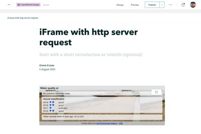

@ChrisMaclaurin -- Yep, understood. That was one of the reasons we looked into trying to make this work since we figured you couldn't really do anything to change the way this service was working.
We've got the fix running in our dev environment (see below), so we're on track for getting it out in next week's release...
Owen Evans
ChrisMaclaurin
Sorry, it's been a while.. yes this is working fine now... I just had to get back to the the creators of the web widget in the first place as the code was not inserting the Name! But all is well the the display in storymaps.
