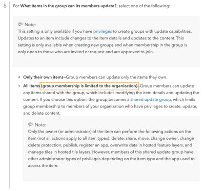

Hello -- Thanks for posting this question. Currently, the ArcGIS platform does not support shared editing across organizations. This is not a limitation of StoryMaps—this is the case for all ArcGIS item types.
I'd recommend adding an idea to the ArcGIS Online idea board (or upvoting an existing idea if it's there already). For reference, this is documented in the ArcGIS Online help system here:
https://doc.arcgis.com/en/arcgis-online/share-maps/create-groups.htm

Thanks for sharing that. The page you've referenced doesn't mention the special case of providing editing access to people in other organizations. It's a general page about creating and inviting people to groups, which are primary used for sharing content to view (not edit).
The link and screenshot I shared above—which is the page that describes how to give other people access to edit an item via a group—does explicitly state that if that option is enabled on a group, the group's membership is limited to members of your organization.
I apologize for the confusion. I understand it can be difficult to find the right information since the ArcGIS help system is large. I can suggest that the documentation team add a note to the page you were reviewing to make it more clear that cross-org editing collaborations aren't possible at this time.

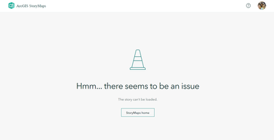

I've set up the collaboration with editing enabled and added the necessary people to edit. Then I added the story map and now I see the option to configure/edit the story map but once I select that option I get the following.
Currently, that story map is shared with me by another user from a different organization and has an organization-only share setting.
Is there a particular step I missed?
PS. One of the organizations is a SAML login infrastructure... not sure if that complicates things...
