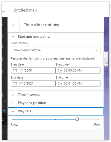

Hi, when viewing the time slider in Map Viewer, you can adjust the playback speed by going to Map Properties then finding the Time menu.
TWPFSecretariat
Is there a way to customize this speed? You are able to use a much faster playback rate in ArcGIS API for Javascript but this playrate scale only goes to 4x speed.
