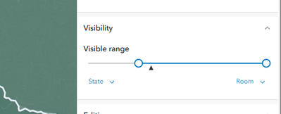

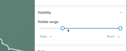

Web map settings:

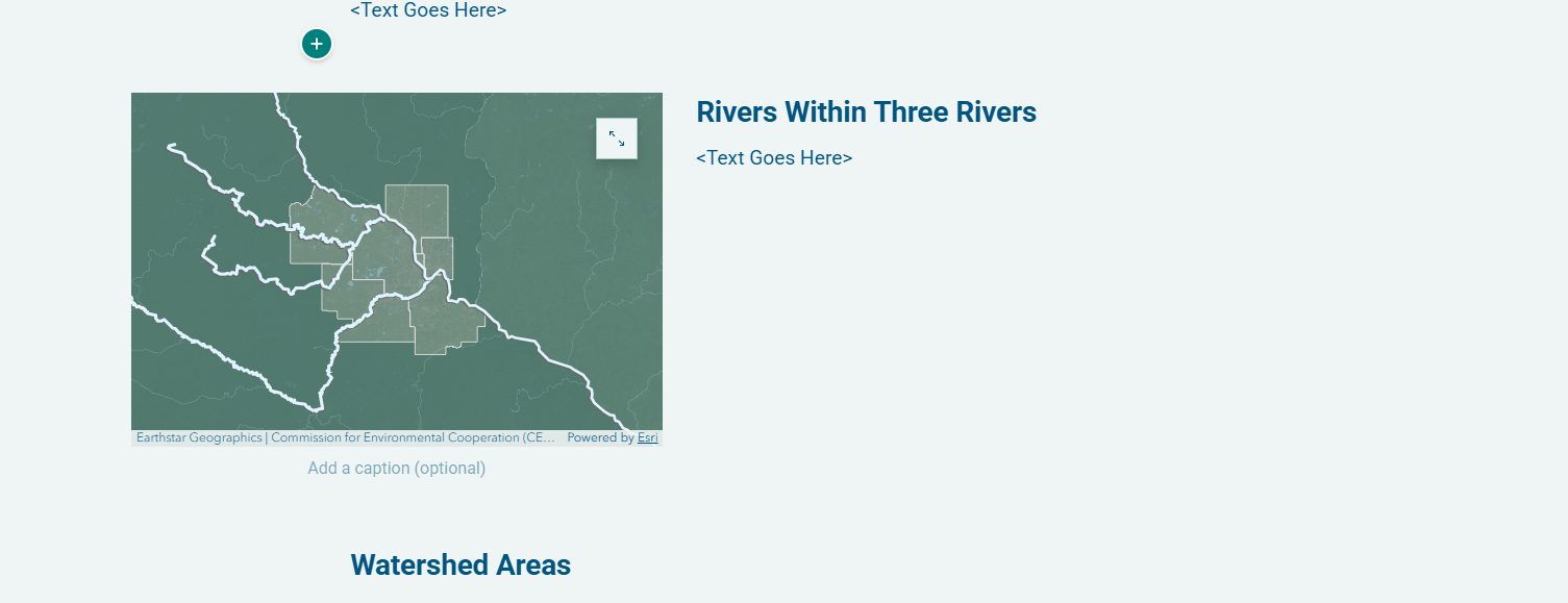

Map Float Left issue (parks set at scale don't appear)-

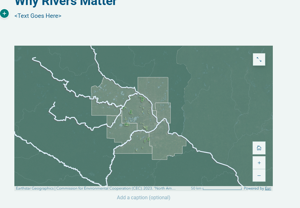

Map when not configured to float (parks set at scale do appear)-

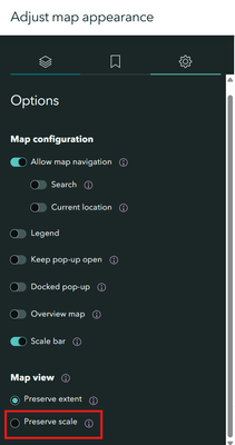

Have you enabled the 'Preserve scale' setting in the 'Adjust map appearance' window?
