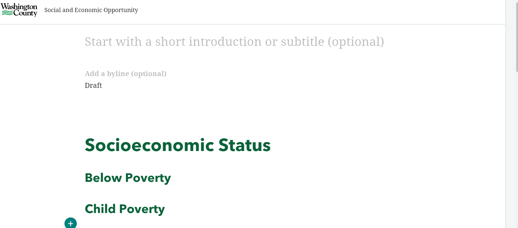

Hello- I am creating my first storymap and having difficulty figuring out how to create tabs across the top. I have added a heading and subheading for what I want under the first tab but not finding how to create tabs. There will be a map under each subheading. I am using a template through my organization- I am unsure if that is why. Any help would be appreciated.

No. You can fake it by using collections. Each heading would end up being its own StoryMap inside of a collection. You subheadings would then be headings w/ navigation within each separate StoryMap.

In the Design panel, toggle on Navigation. It will create links at the top to your headers.

Thank you- Is there a way to create tabs with the subheadings under each tab for the headings? For example in my screenshot once you click Socioeconomic Status along the top have tabs for Below Poverty and Child Poverty?
JenniferAcunto

This is certainly how I do it. Good response Jen
