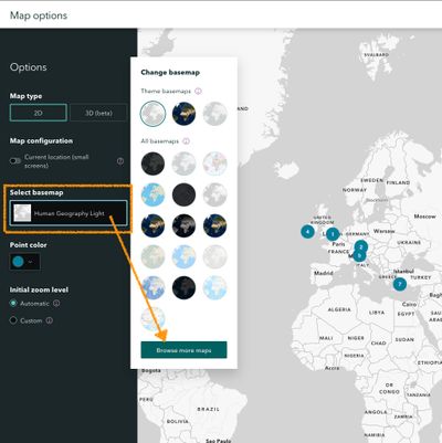

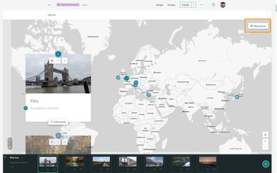

In the map tour's map options you can bring in your own web map to replace the default tour basemap. If your web map has layers, those layers will be visible in the tour.
This is documented in Map tour building tips section here. (see screenshots below).
Change the default basemap in the Map tour map options settings. In the Change basemap panel, you can change the basemap to one of the following:
Theme basemaps—These basemaps are based on your selected theme and change as you apply different story themes from the design panel.
All basemaps—If you choose a basemap from the All basemaps section, the basemap persists even if the story theme is changed.
Web maps—Click Browse more maps to select a web map. You can select web maps from My MapsMy FavoritesMy GroupsMy Organization, and Living Atlas. For any map you select, all layers in the map appear in the map tour, but pop-ups are not available. Any changes made to the web map's contents are reflected in the tour.
