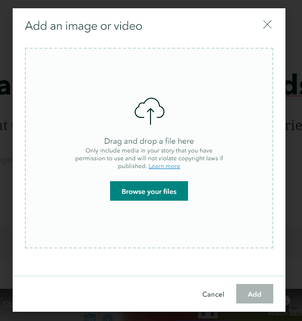

I'm trying to add a link to a youtube video to a Explorer Map Tour as the media for a card and a video as a Content Block. When I click to add, I only get an option to upload from my PC and no option to add a link. I've looked through the help documentation and it seems like I should be able to use a link to the youtube video as an option. Is there a setting my administrator might have change that restricted this or is there something I need to do?
This is the window I get when trying to add a Video:

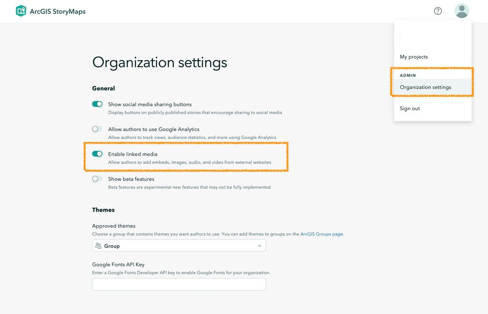

Yes, there is an organization setting on Enterprise portals that can be used to disable the ability to add linked media in StoryMaps. Only administrators have access to view or update the settings on this page, which is accessible via an admin's profile menu. These settings affect all members of the portal organization.
Yesterday, we added a new help topic that lists and describes these administrative settings, which you can find here: Administer ArcGIS StoryMaps on ArcGIS Enterprise—ArcGIS StoryMaps | Documentation

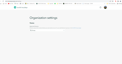

I am using Story Maps on the ArcGIS Online page and have the same problem. There are no general settings under the organizational settings so I think I am looking in the wrong place or missing something since I cannot link to content (embed, video, image)-- I only have the upload option

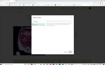

TPB_COGGIS_Team_0-1646748199193.pngThe setting page and the story map showing the option to use a link to video is disabled. thanks-
OwenGeo
Esri Notable Contributor
Hmm, I'm sorry but don't understand what you are referring to in the second screenshot. I see the Link option as active, not disabled.
What happens if you paste a link in the field on the right side of that panel?
