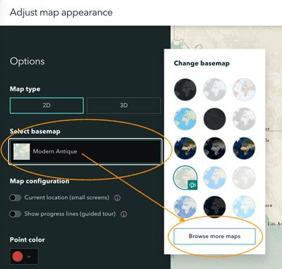

@JB3T - To have additional layers in a map tour, you can update the basemap of your map tour to another web map that contains the layers you need.
Click Edit (pencil icon) on the map tour map, then click the tile under Choose basemap, and then Browse more maps. From there you can select the web map that has the layers you want to show in your map tour.
