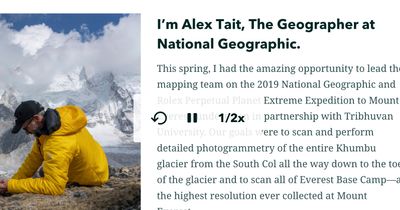

This is already available. You can use the "speed" parameter in any bookmarks you have to set the speed for autoplay. Slow = 1/2x, medium = 1x, and fast = 2x. Be sure to also include the "play" parameter as well. For example:
https://storymaps.arcgis.com/stories/c87bc0a59c0144008e25d50a5dd1b192?play&speed=slow
After autoplay started, the speed can also easily be updated from the control panel that appears when you move the mouse.
