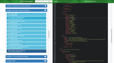

I see you're using the Classic StoryMaps. You can change the theme colours by editing the JSON. The easiest way to do this is using the ArcGIS Online Assistant
  1. Login with your AGOL username and password
  2. Go to 'I want to...' in the header menu and select 'View an items JSON'
  3. Navigate through your folders and select the StoryMap which you would like to edit
  4. As you scroll down, you will see two windows containing the JSON code
  5. Go to the 'Data' window and click on the edit icon (pencil)
  6. Near the beginning of the code, you will see a section called "theme" and you can update the colours by pasting in the hex code or RGB value
  7. When you are done, click 'Save'
  8. Reload your StoryMap and the new theme colours should be displayed.
P.s. It's worth saving a copy of your StoryMap or the original code somewhere before editing, just in case something goes wrong!

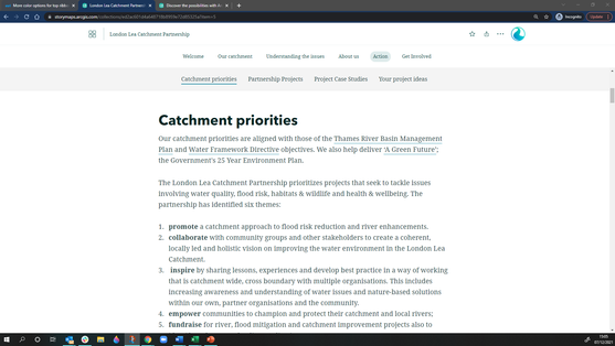

You can create the same functionality in the new StoryMaps using StoryMap Collections.

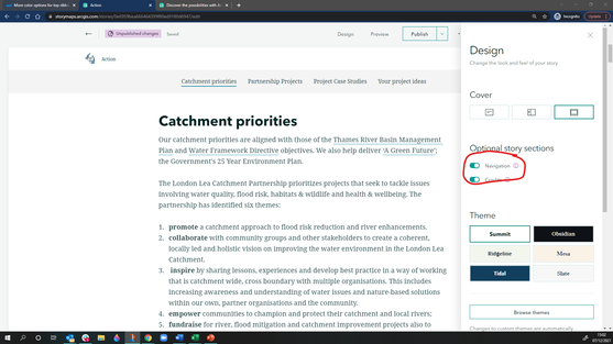

You simply need to turn on navigation in your StoryMaps to create the sub menu:
And then bring them together in a StoryMap Collection to create the main menu:
Check out this blog post: Create your first collection with ArcGIS StoryMaps
