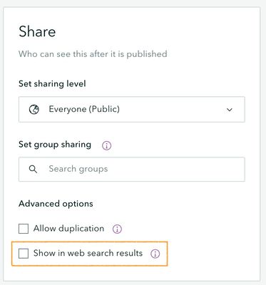

OwenGeo
A very similar "private link" option is already available in ArcGIS StoryMaps.
When publishing, share with Everyone but uncheck "Show in web search results." This ensures your StoryMap will not be crawled/indexed by web search engines, so it will be available without a login to those you share the link with, but it will not be discoverable in web search results. When you are ready for the item to be widely shared, republish and re-check this box so the item will be marked for search indexing.
The only difference is an item hidden from web searches may appear in ArcGIS Online searches, which are much less common than web searches. Otherwise the behavior of this option is exactly the same as the previous StoryMaps.com "Anyone with link" option.
