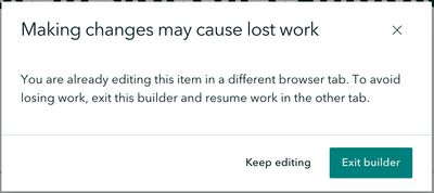

There is a different, specific message that is shown if the same person has the story open in multiple tabs (see screenshots below), so you will know if it's you or someone else who is creating the conflict. However, as long as you are not making changes across multiple tabs that message won't appear.

Unfortunately we can't automatically close someone's browser tab if they choose to leave it open and don't go back to it. But if they aren't making changes in those other tabs, they won't affect anything but their browser's current memory consumption. As I mentioned above, open tabs don't affect the back-end system unless changes are being made, so there's really no active connection for us to "time out."
We already communicate to the author if they try to make edits in across different tabs, but if they are running into browser memory issues because they have too many tabs open, I'm not sure we can do much more on our end to help with that. 😕
