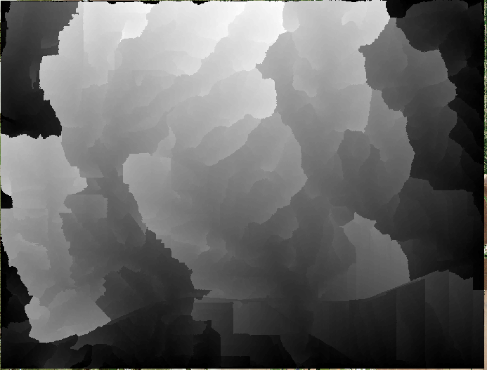

I have a flow length raster that shows the range between the lowest flow path and the longest flow path. I need to take the longest flow path and actually draw out the path. What is the best way to do this? I cant use ready use services and not use the advanced license of ArcGIS.

If you have access to the Spatial Analyst extension, typically, the next step would be to run a "Flow Accumulation", followed by a "Stream to Feature".  Note that the Flow Accumulation may require a few runs with different settings to come up with a usable output.
Source:  Deriving runoff characteristics—Help | ArcGIS for Desktop
Flow Accumulation—Help | ArcGIS for Desktop
Stream to Feature—Help | ArcGIS for Desktop
The final part, finding the longest flow path from the many lines output in the "Stream to Feature" can be a challenge if you don't want manually go through the output linework and sum lengths.  See the below thread for some ideas on how to automate this.  Note - I have not tried it, but the python script posted by Luke Sturtevant  looks promising.
using the Flow Length tool in Spatial Analyst's Hydrology Toolbox to find the Longest Flow Path
