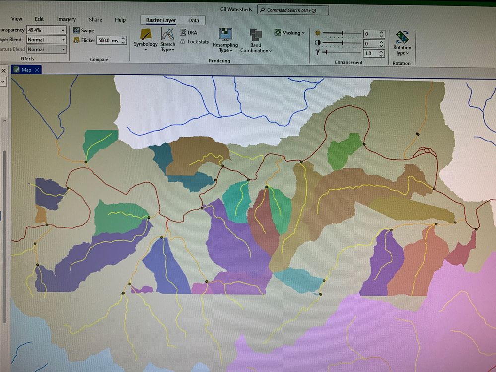

When delineating sub-watersheds within a major watershed, the delineations are cut-off in a straight line on north, south, east, and west.
Pictures included of example. The major watershed in beige delineated normally with no cut offs. The colorful smaller ones stopped delineating at a northern, southern, eastern, and western boundary.

You may notice that the limits of the "cut off" match the extents of the batch points. This has happened to me. You can avoid this as I have by ensuring the processing extents include the DEM you are using.
Mark

djackson0635
Mark,
You are a hero.
Thank you.

Lol, The true hero will be the ESRI person who fixes the code to avoid this issue. - M
