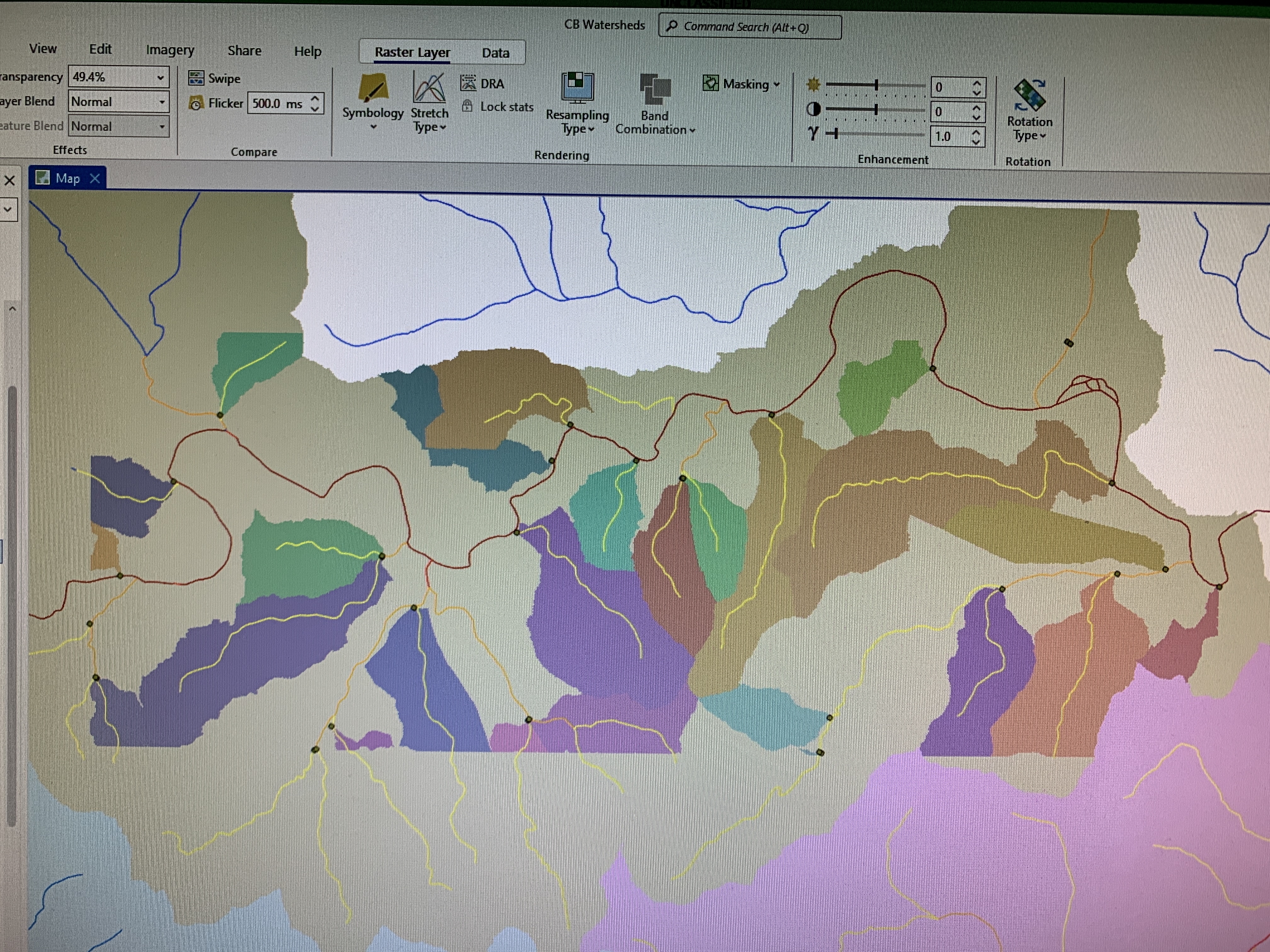

When delineating sub-watersheds within a major watershed, the delineations are cut-off in a straight line on north, south, east, and west.
Pictures included of example. The major watershed in beige delineated normally with no cut offs. The colorful smaller ones stopped delineating at a northern, southern, eastern, and western boundary.
issuephoto.jpgSorry for image quality

You may notice that the limits of the "cut off" match the extents of the batch points. This has happened to me. You can avoid this as I have by ensuring the processing extents include the DEM you are using.

Mark,
You are a hero.
Thank you.
