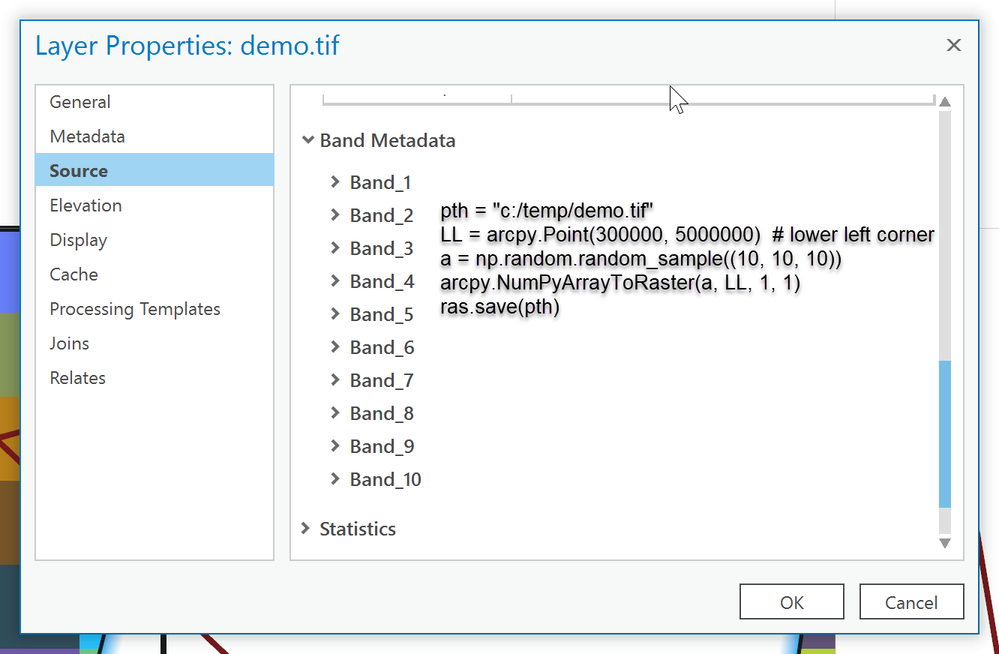

You can also bring the results back in.  In this example, I created a 10 "band" raster in NumPy and brought it back into ArcGIS Pro
And you can bring it back to numpy
b = arcpy.RasterToNumPyArray(pth)
b.shape
(10, 10, 10)
(a == b).all(-1) # ---- equality check, to make sure input and outputs are equal
b.shape
(10, 10, 10)
