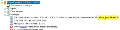

I wanted to do some radiometric corrections on band 1 but raster calculator fails and it gives me this message. I already uninstaled and reinstaled arcgis but te problem stays. My teacher didn't know what to do either.

Lots of places things can go wrong
BUG-000115280: Raster Calculator returns the Error 000539 when the .. (esri.com)
if the expression originated from modelbuilder for instance
Error: ERROR 000539: Error running expression: rcexec() (esri.com)
or dozens more links
Esri Support Search-Results
But in short, try saving the output to a simple folder as a tif file rather than into a geodatabase in the Users folder (ie c:\temp\answer.tif)  And make sure you are using the Raster Calculator in the Spatial Analyst Toolbar.  And finally... if you are using arcmap switch to ArcGIS Pro

Hello,
I see in the error message that a *.tif is trying to be written into an fgdb, *.tif cannot be written to an fgdb.
Try removing the *.tif from the output raster name, or write a *.tif to a folder not to an fgdb.
