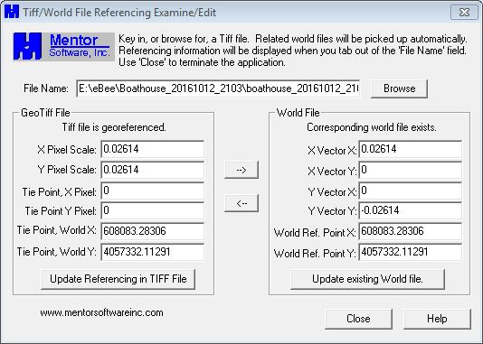

Here is the GeoTiff header and ftw file information of an input file, with matching information:
GeoTiff header vs. tfw information of input file

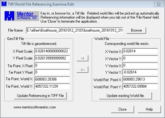

And here is the information from the resulting output tiff file after the Raster Calculator operation:
GeoTiff header vs. tfw information of output file
The cell size in the header has changed by a very small amount, and the tfw corner coordinate has changed by 0.01307, or 1/2 pixel.
Anybody know why the output Tiff/Worldfile referencing is not identical to that of the input, as one would expect it should be?

the tiny tiny difference is floating point representation (not to worry).  The half cell offset, I vaguely remember a link that some processes allow you to specify cell center vs cell bottom left when creating the output extent and i can't find it or remember which process has both options enabled.  Hopefully this triggers someone's memory
