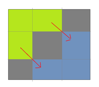

2. Its tough for me to tell from the images, but you need to be careful to prevent 'leaky barriers' when using rasterized linear features as elements in your input cost surface. If such a linear feature gets rasterized into cells that are strictly corner connected, then the cost distance 'spreading function' will move through the other diagonal and effectively ignore the barrier. In the image below the grey cells represent the raster version of the barrier (or high cost area). That barrier is ignored because it is only corner connected. Accumulated cost can propagate diagonally across it.
One way to avoid this is to create an intermediate raster from your linear cost inputs and apply the focal statistics tool to 'thicken' the barrier. Focal statistics will spread whatever cell value you want from the rasterized linear feature to the adjacent cells. You then incorporate the thickened, rasterized, linear feature, into your final input cost surface.
