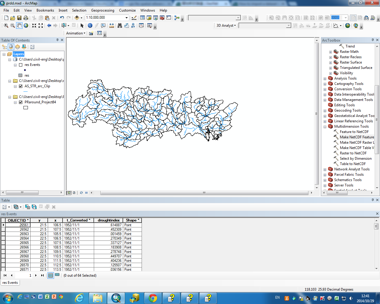

I have converted my data using "transpose field" and "convert time field" to make it time-enabled so now the data is like:Untitled.png
the data table comprises of five(or six) columns, ObjectID, latitude, longitude, date, index(variable to be mapped through interpolation), and shape.
I have enabled time( in the properties time tab) but I still need it to interpolate to create a surface like in the thread I posted in a batch processing.

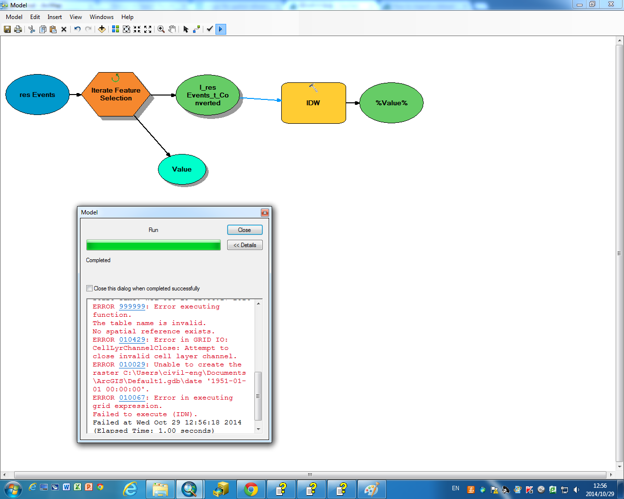

3. To use model builder, and use "iterate feature selection" but it showed error that I can find no way to fixed. I tried to change environment setting but nothing worked.Untitled.png
