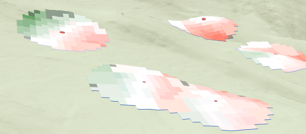

I recommend using either the Euclidean Allocation or Distance Allocation tools to generate the buffer regions around your source points. Add an integer field to your source features that contains their (rounded) heights. Use the Maximum Distance parameter with the EA tool or the Maximum Accumulation parameter with the DA tool to specify the buffer radius. Specify the height field as the source_field. These tools will do both the buffering and allocation (for nearby sources).
You then simply subtract this result from your elevation surface to obtain the source-relative height offsets. The subtraction output will be NODATA in the areas where the buffer hasn't reached, which is what you want. You can reclassify the results, or use a multi-part stretch renderer with the middle interval point set to zero to visualize these results.
The graphic below shows the results of how allocation assigns cells to nearby sources correctly, and how a stretch renderer is used to color the results relative to each source cell. Shades of red are used for cells beneath their sources , shades of green are used for cells above their sources, and white is used for cells at approximately the same elevation as the sources.
Here are some additional comments:

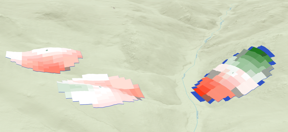

1. The DA tool has the ability to calculate true distance over a surface, not just distance in the horizontal plane of the projection. I think this could be a game changer for many applications. True surface distance is what you would probably measure in the field. I've shown an example below. The buffer region on the right was calculated two different ways. The blue circle underneath is the 200m buffer calculated using distance in the plane of the projection. The red-white-green buffer was calculated using true surface distance along the hillside.
For the upcoming 2.8 release of the Spatial Analyst, the SA team will ship substantially updated conceptual documentation for the new SA distance toolset, that elaborates on these new capabilities. I recommend reading through this documentation carefully, when it becomes available.
