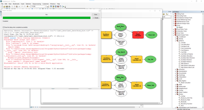

Hello,
I am having this issue when I try to run the raster calculator using the following syntax" Con("%Road_Dist.tif%"<=150,0,1)
I believe it has to do with python, but I can't figure the issue. Thanks in advance.

your error messages has references to python 2.7 and python 3.7.
Are you running this in arcmap or arcgis pro?
Did you type in the calculation for the raster calculator or validate otherwise?

I installed ArcGIS Desktop, but I also had the option to install ArcGIS Pro. This issue took place as I was running ArcMap.
I used the calculator in the raster calculator for the expressions, I only typed the commas. I don't know how to validate.
