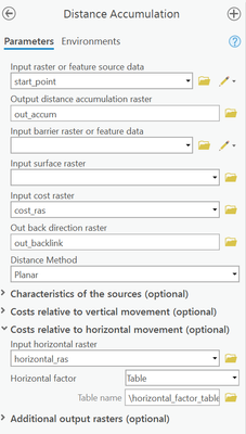

Hi! I'm getting a crash without an error message on Distance Accumulation tool on ArcGIS Pro 2.7 when using a horizontal factor table. Without HF or with the predifined HFs the tool works correctly. Same goes for the legacy Path Distance tool. The exact same files work ok on ArcMap 10.8's Path distance.
Anyone else experiencing this or is it just me? Here are some test files:

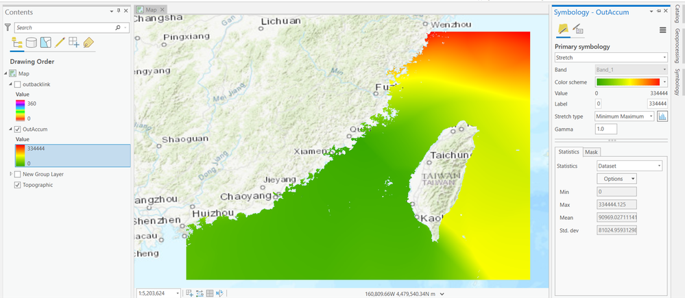

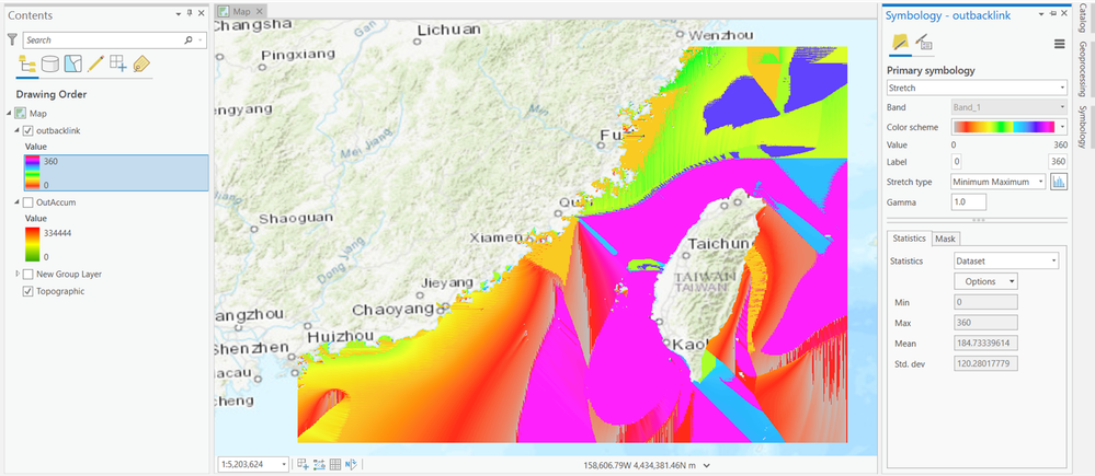

Sadly I have to be the annoying person that says 'it works for me'.  Pro 2.5...
No idea what I'm looking at, just threw the inputs in.
wesape
Thanks! The results look correct. Works for me as well if I go back to 2.5.
