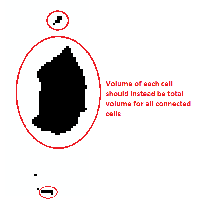

I've got a raster that represents the water depth at a specific return period for a whole municipality (e.g. a lot of cells both with neighbours and single cells). The grid is a 10x10 m, so I know I can calculate the volume of each cell as depth x 10 x 10.
What I then need is to group these together, so that I get the sum of all connected cells, preferably I then need to convert that to a vector/area/polygon with the total volume.
So basically all individual raster cells that touch each other need to be summed up and grouped together.
I've got 3d analyst and spatial analyst license along with Standard Arc license.
Any help would be much appreciated.

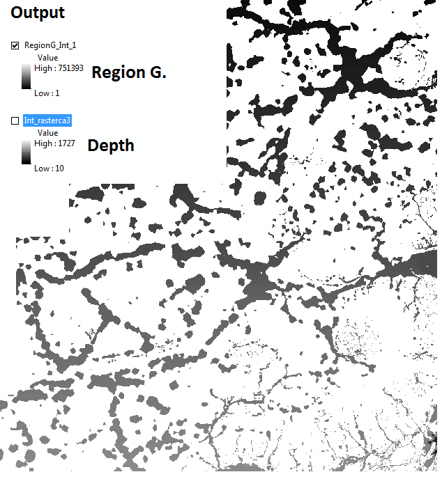

Alright, I've tried what you suggested with the below output. I'm not quite sure (even though I've read the How it works) what I'm looking at to be honest. (Might be I'm just a bit slow).
Input was Int_RasterCa3, which is the depth in each cell Unit: Centimeter. The output RegionG_Int_1 has a whole different spectrum, also when I use Identify it doesn't look like adjacent cells are grouped?

I would suggest at this point that you have many many single valued regions.  If you want to keep those that is fine, but otherwise you may want to remove those.  If it worked though, maybe you could mark the thread closed.
