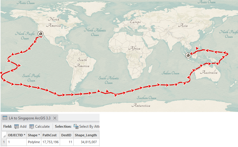

Before ArcGIS Pro 3.4, distance analysis could only perform calculations within the edges of a projection. For instance, when accounting for prevailing wind directions, the shortest calculated sailing route across the ocean from Los Angeles to Singapore would circle the southern tip of South America. This route, shown below, covers about 34,800 kilometers.
Using prevailing wind directions, the calculated route prior to ArcGIS 3.4 is 34,815 Kilometers.Using prevailing wind directions, the calculated route prior to ArcGIS 3.4 is 34,815 Kilometers.

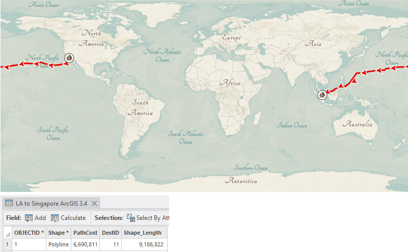

With the improvements in ArcGIS Pro 3.4, being able to cross the extent boundary results in a much shorter distance between the start and finish points. The calculated optimal route now cuts a path directly across the Pacific in the northern hemisphere. This significantly reduces the travel distance from Los Angeles to Singapore to about 9,200 kilometers.
Starting in ArcGIS Pro 3.4 the shortest route, using prevailing wind directions, is 9,187 Kilometers.Starting in ArcGIS Pro 3.4 the shortest route, using prevailing wind directions, is 9,187 Kilometers.

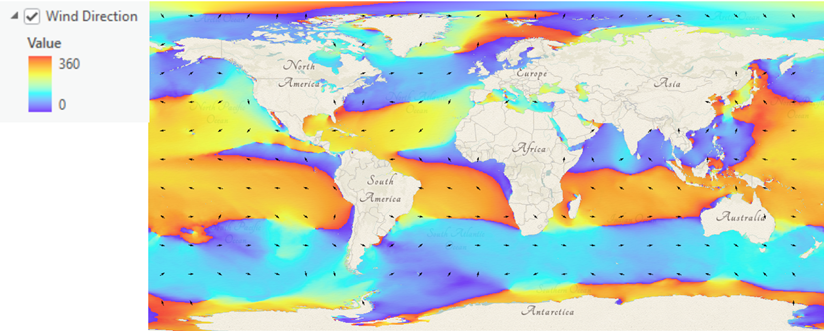

Wind direction data for August 2024 can be used in conjunction with the table to predict the routes the sailboats would take.
Wind Direction (August 2024) calculated from Copernicus Climate Data Store ERA5 monthly averaged data.Wind Direction (August 2024) calculated from Copernicus Climate Data Store ERA5 monthly averaged data.

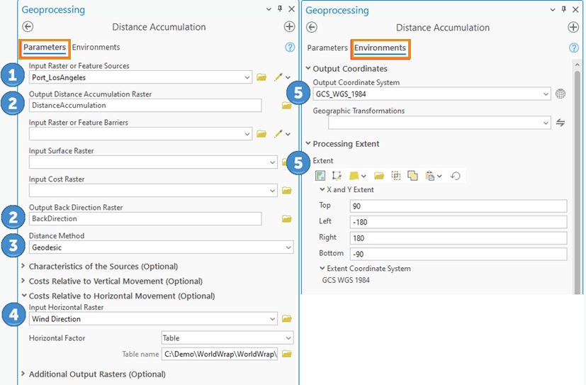

In the Distance Accumulation tool, set the following parameters:
  1. Specify the input source to the Port of Los Angeles
  2. Give output names for the Distance Accumulation and Back Direction rasters.
  3. Specify the Geodesic distance method.
  4. Specify the Input Horizontal Raster as the Wind Direction raster and specify the Horizontal Factor parameter as the table relating the cost of travel relative to wind direction.
  5. If your input data is not in a geographic coordinate system or a cylindrical projection, specify an output coordinate system. Also, your analysis must cover an extent that spans from -180 to +180.
  6. Run the tool
Setting these parameters and environments is the first step in calculating an optimal sailing route.Setting these parameters and environments is the first step in calculating an optimal sailing route.

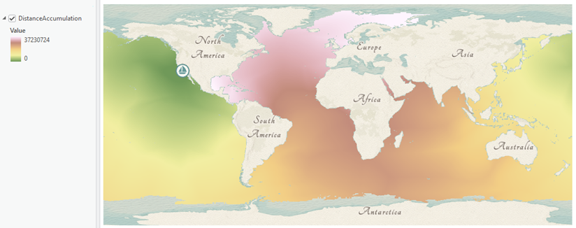

This is the Distance Accumulation raster generated by running the Distance Accumulation tool. Every location in this result has a value that is the distance back to the Los Angeles port following the most optimal or least cost path.
The Distance Accumulation result.The Distance Accumulation result.

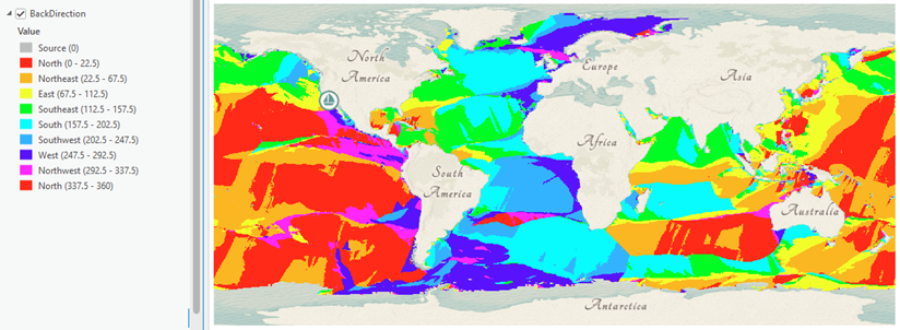

This is the Back Direction raster generated by running the Distance Accumulation tool. The Back Direction rasters have values from 0 to 360, indicating the directions back along the least cost path to the sources.
The Back Direction raster result from the Distance Accumulation tool.The Back Direction raster result from the Distance Accumulation tool.

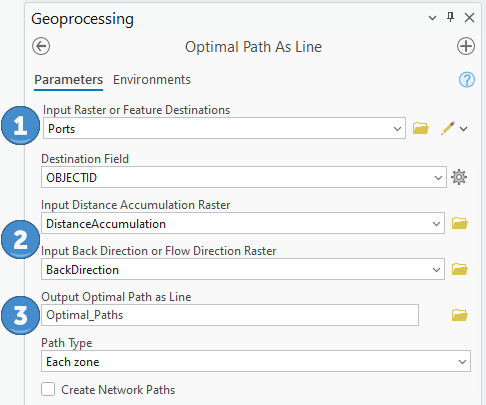

In the Optimal Path as Line tool, set the following parameters:
  1. Specify the destinations. In this example, the destinations are the ports we want to generate sailing routes to.
  2. Specify the inputs you just created in the Distance Accumulation tool.
  3. Provide an output name.
  4. Run the tool.
Setting these parameters for the Optimal Path as Line is the second step in calculating an optimal sailing route.Setting these parameters for the Optimal Path as Line is the second step in calculating an optimal sailing route.

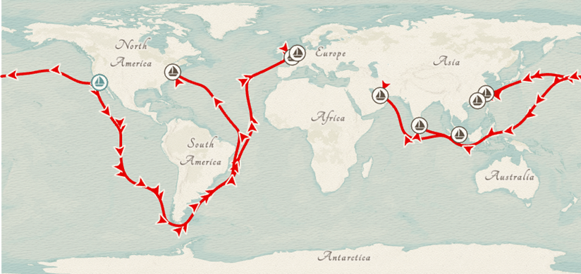

In the map below, you can see the most optimal paths from the Port of Los Angeles to several ports around the globe. Some of these optimal paths go across the Pacific while others go around Cape Horn, the tip of South America.
Without changing the central meridian of the map, this analysis created sailing routes that go beyond the boundary of the map extent, allowing for around the world calculations in both directions.Without changing the central meridian of the map, this analysis created sailing routes that go beyond the boundary of the map extent, allowing for around the world calculations in both directions.
