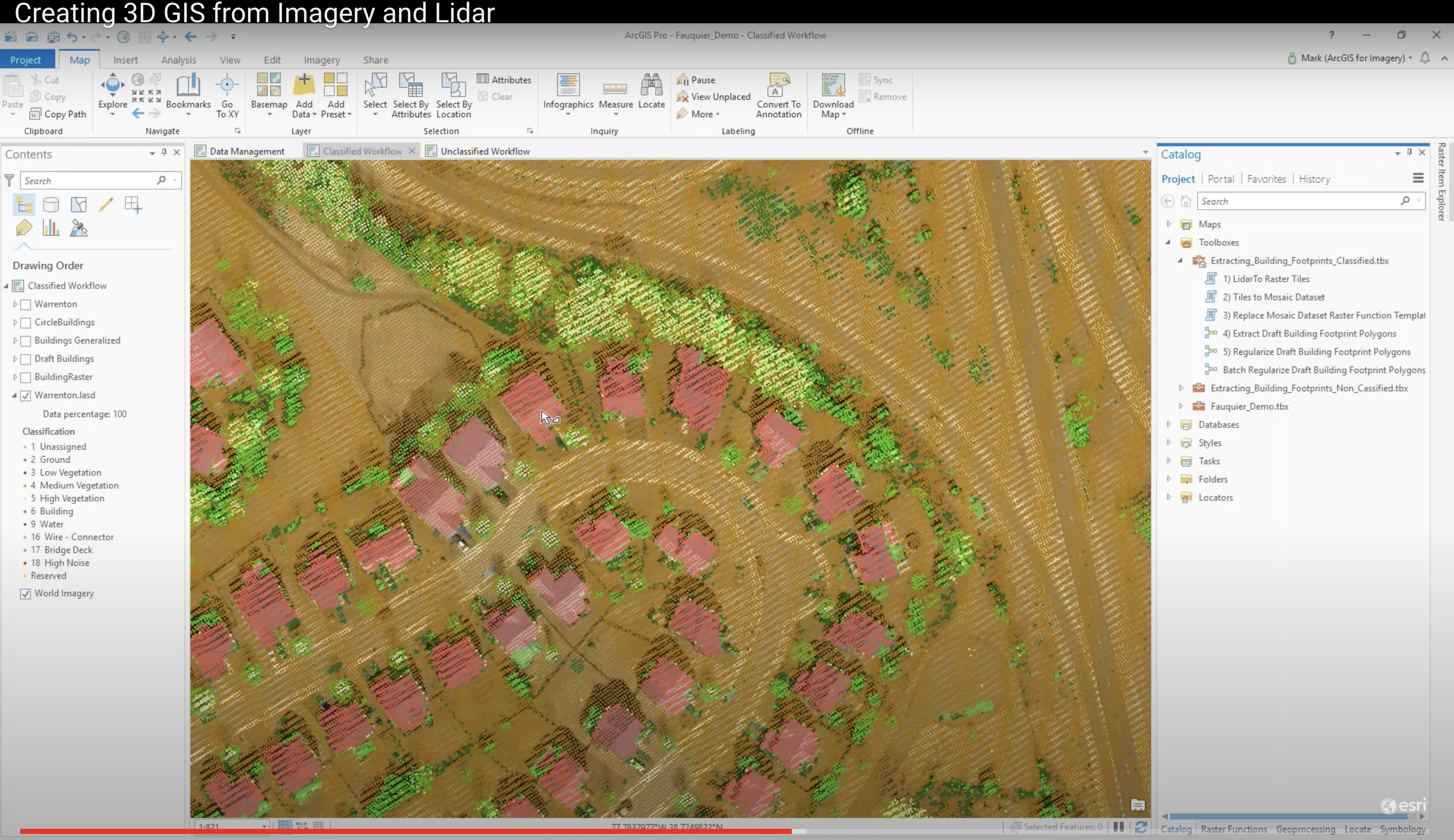

I am attempting to extract feature data from classified LAS files I have for Oak Park, IL. I see it being referenced in several videos (see below) but cannot find the actual toolbox. If the toolbox cannot be downloaded, is there another way to extract the features? I am attempting to create an updated building footprint.
The toolbox steps look like:

Jennifer - I believe you can learn more about it here (it's on mature support) but a new version (3D basemaps) may be downloaded via the ArcGIS Solutions app here
Hope this helps!

JenniferGoldman
Robert,
Thank you for your helpful reply. This worked perfectly. If a feature like 3D Basemaps isn't enough to get a Desktop gal to move to Pro, I don't know what is!
