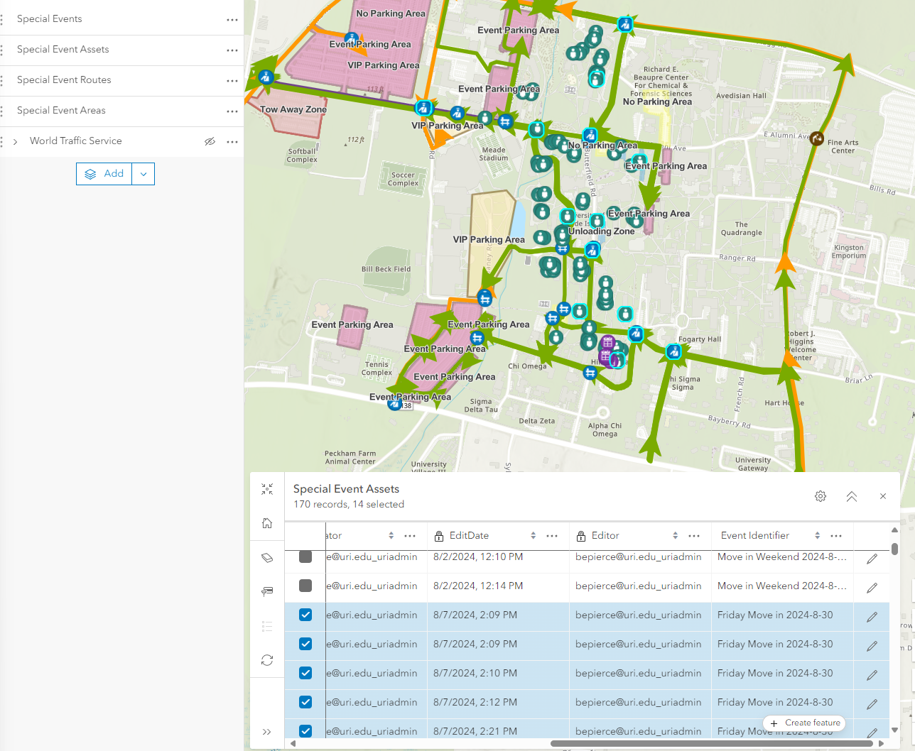

Any ideas why special event assets would show up in the site map web map, but not in the site map application?
In my example, the "Friday Move in" assets are appearing in the web map:

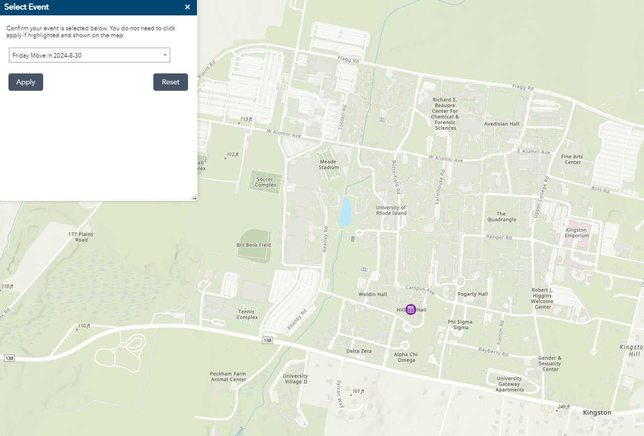

But the assets are not showing up when I apply the filter to the site map application:
Only the event point feature appears on the map when I apply the filter.

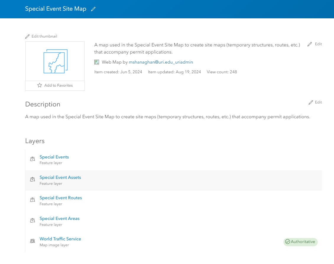

It appears that the "SpecialEventAssets_approved" layer view does not contain any of the Friday assets. I wasn't aware that this layer existed until now and I don't know how to "approve" the Friday assets.
It shouldn't matter anyway because the Site Map web map doesn't use this SpecialEventAssets_approved layer view:

Hi, thanks for your response. I do not see the assets when opening the site map application alone or when opening the site map through the event manager application as shown in your png.
The assets are present in the SpecialEventAssets layer attribute table and are visible in the site map web map shown below.
 Does the site map web application use some kind of filter to only show assets which are "approved"?
