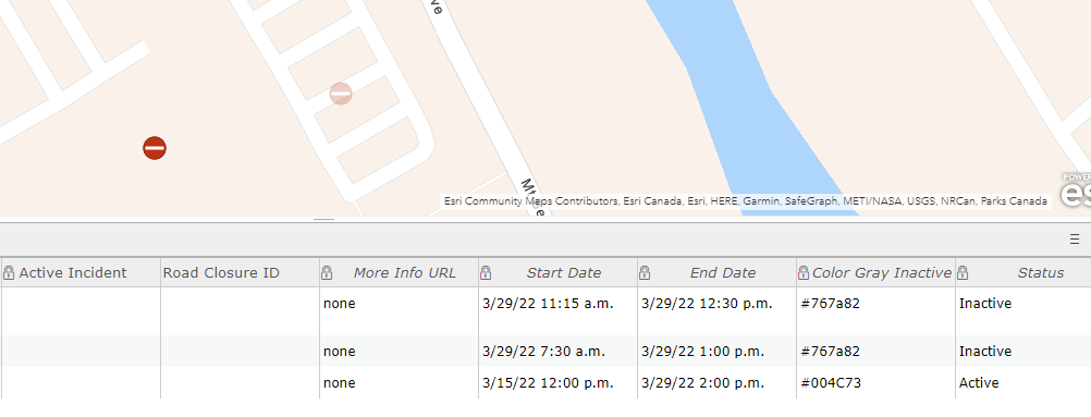

When an active and inactive feature is present the main feature layer has all the data present in the table and viewable by transparency:

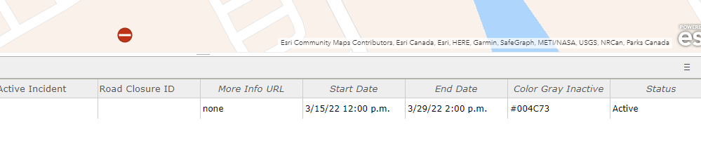

the public view layer has only the active present in the table and viewable, anything inactive disappears:

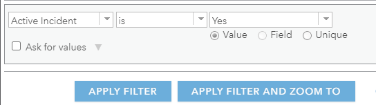

The public layer also has a filter for the active incident field but this field doesn't seem to update when adding new closures and when applied, nothing is visible.

@RobynSnookCCB, the solution is configured with custom filter expression on the layer in the view. This kind of expression can't be configured through the UI. The easiest way to replicate it would be use a tool like ArcGIS Assistant to edit the web map and update the "definitionExpression" of the layer to be something like below. In the example below endtime is the name of a date field in the service.
endtime IS NULL OR endtime >= CURRENT_TIMESTAMP
