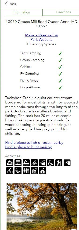

I'm try to mimic the web app (https://statelocaltryit.maps.arcgis.com/apps/webappviewer/index.html?id=5ab754a588724888ac4585b7dc7d...) that I found from ESRI Recreation Outreach solution page  (https://storymaps.arcgis.com/stories/88435bbb90954f2380e2cc42eb5bc837).  The solution (park locator) has a totally different look and feel to the solution web page.
Below image is what I trying to mimic.
Next image is what I have:
I want to have the  Amenities and Activities have similar look and feel.  I'm trying to figure out, how it was done.  Any help would be appreciated.  Maybe if the web map that was use for the app could be shared with me.

Thank you Johannes for the response!  The solution has an arcade expression, but for some reason it doesn't show the check mark in the near me widget in the Web App Builder.  In the expression, you see there is an check mark symbol.  Which I don't understand how they get it in the expression.

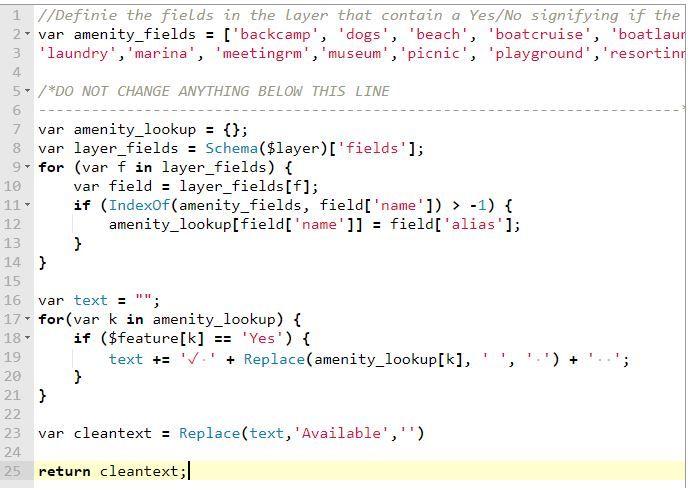

I wanted to offer some clarity on this. The storymap you referenced in your first message contains links to an older version of the Recreation Outreach solution. The version available now, version 2.0, is the version that contains the Arcade referenced above. It uses a single Arcade expression to list out the Activities and Amenities with the checks, and uses the Nearby Instant App, instead of WebApp Builder.
If you're not seeing the check marks in your pop-up, I would suggest making sure the fields listed in line 2 of Arcade expression are populated with 'Yes' or 'No' in the ParkRecreationFacilities layer. The fields are what drive the pop-up to create the check mark. If the fields aren't populated with anything, no checkmarks will appear.

Thank you Lauren the info!  Yes, all the fields are populated correctly.  I copied the expression from the Nearby Instant app and put it in the Near Me widget and it doesn't display the check mark like it does for the Nearby Instant app.  I don't know, if it is a bug, but the storymap I referenced has those elements (activities/ amenities) working.  I was hoping to be able to see the web map used for Near Me widget.  Would it be possible to have it shared to me?

The expressions with the check marks are in lines 9-25. Here's an example of the arcade in those expressions:
function symbol(feature){
    /* Yes value returns a Check Mark, No Returns an X */
    var display = iif(feature == "Yes","✔","")
    return display
symbol($feature.grpcamp)
Hopefully that gets you where you'd like to be! If not, feel free to reach out directly at [email protected]. We are always happy to hear how users are deploying our solutions!
