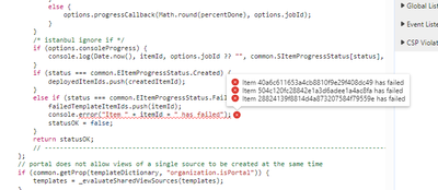

Trying to deploy Address Management Solution in 11.2; however, will start to build and then fails with the error "failure to deploy solution." On inspect can see where all the components are attempting to deploy then failure. See error in image.

@Lacy_House, all the items that are referenced there in the error are Feature Services included in the solution. Could you try something to test if there is an issue with deploying hosted feature services in the portal?
  1. From the Content page in your portal, click New Item
  2. Click Feature Layer > Use a Template
  3. Select the AEDs and then Next through all the other dialogs to create the service.
Does it successfully create?

Completely missing the option to create a new (Feature Layer).

It appears either your user account or Enterprise portal doesn't have the necessary prerequisites to publish hosted layers. See the documentation below for more information:
https://enterprise.arcgis.com/en/portal/latest/use/hosted-web-layers.htm
Most solutions include hosted feature layers which require this functionality be available in the portal in order to deploy solutions. If you enable this ability you should no longer see this error when deploying.
