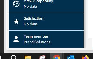

The My GIS Activities dashboard has been configured to filter by the "username" of the individual logged in.  If You go to the dashboard in edit mode, scroll down in the Sidebar to the filter "Team member" you will see your username has been populated in the filter.  If you assign the activity to yourself you should then see the activities.
Please make sure you have done this "Modify team member list" configuration for this to work: https://doc.arcgis.com/en/arcgis-solutions/11.3/reference/configure-gis-request-management.htm#ESRI_...

StephenKing3
@BrandiRank22 , thank you. I had changed the 'modify team member list' configuration but had the wrong value for the username under 'name' in the XLSForm. All working now.
