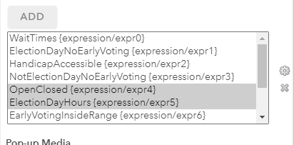

It isn't clear to me where I can indicate the hours of operation for each of the voting locations. I add a new attribute to the table (hours) in ArcPro as each location is only open on the early voting date (October 15) & regular voting date (October 24) from 10am-4pm. The attribute displays in ArcGIS Pro but when I look at the layer on ArcGIS Online it doesn't appear, therefore I cannot reference it in the pop-up configuration.

Seems like you've already found a workaround, but also want to share that there's also an earlyvotingdate field as part of the voting locations layer to represent the day in which early voting begins. It's intended to be used with the nextelectdate to show the time period that early voting is available.
Since there's only one day for early voting, and one actual election date, you could use those two fields in the Custom Attribute Display pop-up, like what you have in the screenshot below. You could then add the hours underneath.
