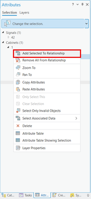

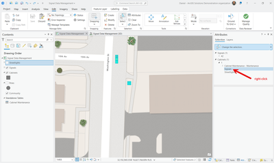

@VeronicaS - The best way to relate existing signals and cabinets is using the Pro Project to edit feature relationships. Download, unzip, and open the Signal Data Management Pro Project, and connect the data sources to the signal, cabinet, and pole layers of the solution in your portal. Then select the cabinet and signal you want to relate. With both features selected, open the Attributes pane, expand the Cabinet feature, right-click Signals, and select Add Selected to Relationship. I've attached some screenshots below to help demonstrate the process. Reach out if you need anything else.

Thank you so much for for getting back to me. I appreciate the response. I was hopeful there would be a way to relate the features in AGOL or field maps, it will change our data collection workflow but I am prepared to proceed with the steps you outlined above.
