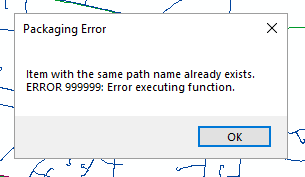

I did get another error that included more information: "Item with the same path name already exists."
screenshot of gpk packaging error
I have no idea which item triggered that name conflict. However, we've ended up remaking both the tools and the gdbs they worked from to ensure unique names of everything, and now it's fine. Thanks anyway
