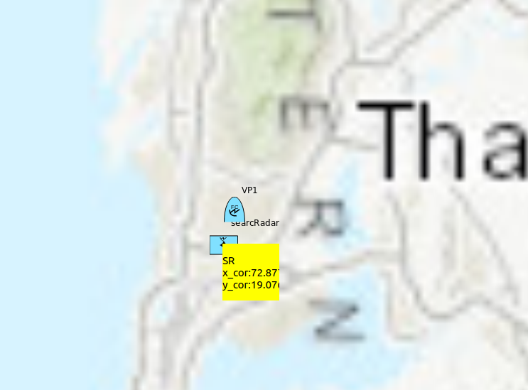

I want to identify graphics on my map on mouse click and display the respective graphic attributes such as name and coordinates. In order to achieve this I want to use a responsive label i.e the label geometry should change as per zoom scale. Another issue is that whenever I click on graphics the map is zoomed in due to the mouseEvent. I am not using the arcgis callout api as I dont want to use any qml code in my application.
Currently my application appears as follows:
Fig 1. On click on graphics it is identified and label is displayed

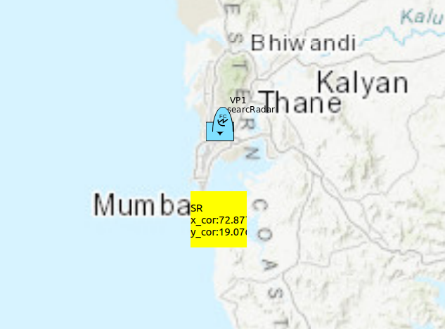

Fig 2. On zooming out label geometry remains unchanged

The QML callout draws a shape using a Canvas and then displays it on the screen using the  LocationToScreen API. Whenever the MapView's viewpoint changes, the draw location is updated with a new screen point. I think you could use the same workflow for your widgets based app. Here is an example workflow:
- Get the Point location of your feature
- Call locationToScreen and pass in your features geometry - https://developers.arcgis.com/qt/latest/cpp/api-reference/esri-arcgisruntime-mapview.html
- Display your graphic at that location
- Whenever the MapView's viewpoint changes (user pans/zooms), re execute this routine
