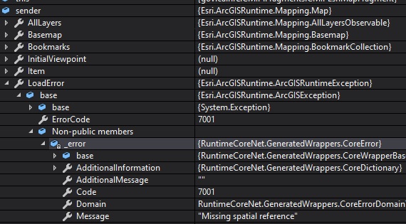

What can I do to mitigate this server error on AGOL. There doesn't appear to be a way where I can set a spatial reference. Here's my boilerplate in OnCreate:

This works usually, but sometimes (varying percentage based on the weather I suppose) throws a rod:
debugger locals window
Breakpoint is at the top of _map.Loaded handler.

TBH I'm a little (but pleasantly) surprised that URL can be used for a Basemap, as that's the endpoint for a layer and not a basemap item. The API reference even indicate that shouldn't have worked 🙂
Anyway, as a workaround, you could try forcing the SR instead :
var bm = new Basemap(new ArcGISTiledLayer(new Uri("https://services.arcgisonline.com/ArcGIS/rest/services/USA_Topo_Maps/MapServer"));
Map map = new Map(SpatialReferences.WebMercator) { Basemap = bm };
You could also try not forcing the SR, but create the Basemap as I did above, and see if that resolves your issue (just to confirm if there's something hokey about using the basemap constructor with a service uri instead of a basemap uri):
Map map = new Map(bm);

ITS_JohnColaneri
So, I updated the libraries, and I added this part:
... new ArcGISTiledLayer( ...
I got a little side-tracked and I don't think I've seen that particular problem again, but I'll monitor it for a couple days.
