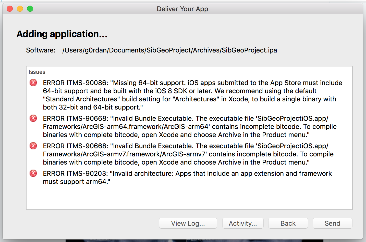

Recently we had new release version of ArcGIS for Xamarin and I got a problem with that.
I can't upload a new build to app store, because I have some errors.
In debug mode it works fine. And with Beta version of ArcGIS for Xamarin it worked fine.

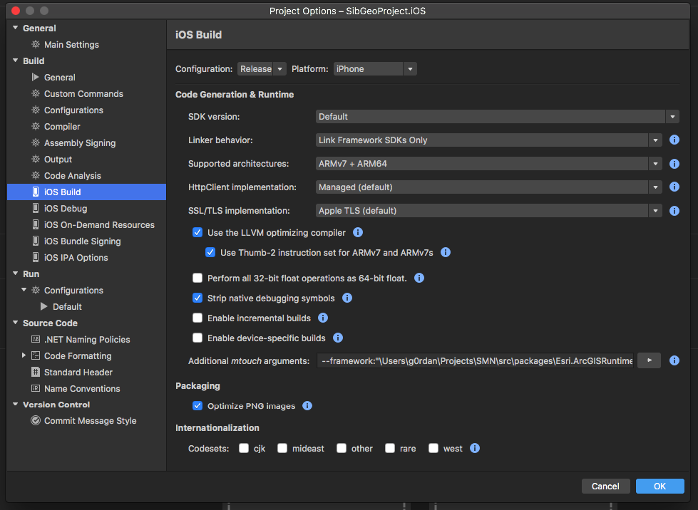

My build preferences is below.
How can I solve the issue?
PS: looks like the ArcGIS framework should be rebuild with ENABLE_BITCODE=NO

A hotfix for this issue is now available.  To get access to the fix, send an email request to qfe1000sdknetx349667@esri.com   Please include your name, phone number, and organization/company name. You can also contact Esri Technical Support directly and request delivery of hotfix QFE-1000-SDKNETX-349667: http://support.esri.com/contact-tech-support.  Our sincere apologies for this issue.  Please let us know if you encounter any further problems with this workflow.
