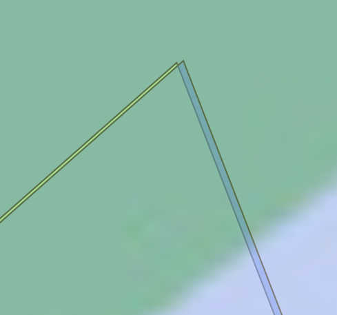

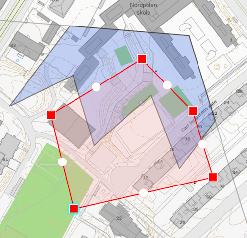

Here are some screenshots of what I am seeing.
I thought I saw an improvement when zooming in before clipping and then back out after, but that had no effect.
The new area in red, will be clipped by the blueThe new area in red, will be clipped by the blueThe new area is created and I just zoomed in on the edge in the green areaThe new area is created and I just zoomed in on the edge in the green area
