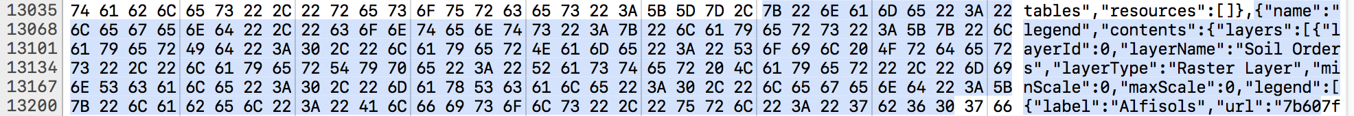

Also to make sure there's actually data in the tpk file, i open it up with hex editor, which gives me this
Which shows there's data in it, but somehow it's not getting it back correctly.
