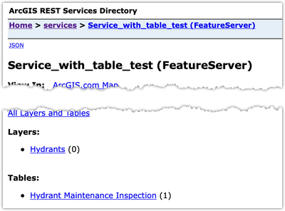

However, when I say "table" above, I mean an actual table definition on the service, which is exposed in Runtime via AGSMap.tables. See this example service definition which lists both a layer and a table:
From your description, it might be the case that rather than using an explicit table, you're using a layer and just not setting a geometry on the records you put in there. If you added that to the web map, as you say, that would get added as another layer, and not as a table, and you'd access it via AGSMap.operationalLayers.
